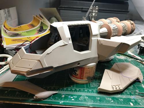

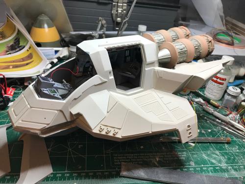

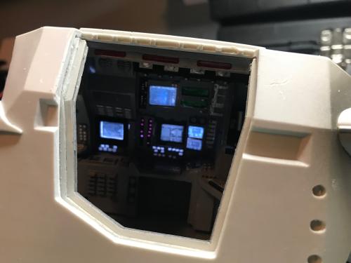

1/25 Scale BSG Raptor - Red III - 03-11-2019 Hey guys, it's been a while since I posted anything here so her are a couple of shots of the 1/25 scale Raptor I have been working on. I used electroluminescent wafer to light up the video panels. Since the parts where cast in transparent resin I was able to just sandwich the EL wafer behind it and light block the parts I didn't want to light. There are standard LED's in the engines. To run the EL stuff you do need to have an inverter to run AC voltage so that will be placed in the base. This is a pretty old kit but it's cast well with very little bubbles or voids. [attachment=19956][attachment=19957][attachment=19958][attachment=19959] |
