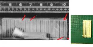

I've just done the magnets on one container so far to see how it will work. I glued a ring and a stack of 3 metal washers on the container. These nest inside and positions the container on the mount point.
[Image: 5.JPG]
The mount point has a magnet glued in, recessed just enough for the part on the container to just contact the magnet. Gluing this in on top of the curved tube so the magnet would be flat was challenging. On this one I used bits of epoxy putty under the magnet first to level it and then poured in epoxy glue to lock it in. This was hard since the glue moved the magnet around and I barely got in into place before the glue started to harden up. 5 minute epoxy is a little too fast sometimes. I came up with a better solution I will show for the next one. Hopefully the new technique will be both faster and more accurate.
[Image: 6.JPG]
First container on. Finally 'moving' along....
[Image: 3.JPG]

Here's how I did the magnet this time. I used this Allen wrench with a couple of small magnet spacers the same thickness as the mount on the container. to hold the actual magnet in place suspended in the glue.
[Image: 1.JPG]
I filled up the hole with epoxy and lowered the suspended magnet into the glue. This way I could position it fairly easily and keep it in place while the glue dried.
[Image: 2.JPG]
Just the 2 containers on so far. It's a slow process.
[Image: 3.JPG]
The secondary mounting point was a bit loose. I think that the containers are not as balanced as they would be if original kit parts and a bit front heavy so this mounting point wasn't really doing much. These are roto-cast which often ends with some extra resin at one end or the other. To counter this I added some thin rare earth magnets next to the post so it would stabilize the whole thing a bit more.
[Image: 4.JPG]
And the opposing spot on the container. These magnets are super thin and perfect for this.
[img][/img]
[Image: 5.JPG]
[Image: 6.JPG]
I also got a bunch of the greeblies done on the engine module. Starting to look better now.
[Image: 7.JPG]
