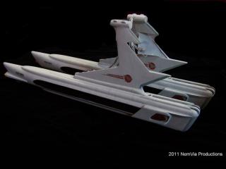

RE: DeBoers Reliant - WIP - NemVia - 05-06-2011
I've added a couple of pics on my site for the Warp nacell assembly. Although there are only 2 pics to look at, there has still been a lot of time put into these babys. These nacells are much easier to assemble than the Enterprise nacells because there is no bottom lip that connects the engine to the nacells. For the most part it's a straight shot when applying the epoxy. These pieces fit together much better than the Enterprise nacells as well. By my next post, I should have all of the seams filled in, sanded sown and ready for opaqueing. All of the electronics are working fine, so that's a big relief because once everything's sealed that's it! We're done! I Should have a few more pics soon. See you next update.
Mark
http://www.NemVia.com
RE: DeBoers Reliant - WIP - NemVia - 06-12-2011
I've finally been able to opaque the nacells for Reliant. They were the easiest to putty and sand because the pieces matched up so much nicer than the Enterprise nacells. By my next update I should have the base colors started on the engines so I can begin Aztecing the engines. See you then!
Mark.

RE: DeBoers Reliant - WIP - NemVia - 08-01-2011
Warp Nacell Update for 07/31/11
For the Reliant project, I don't have any more than 2 new pics to show you because I haven't got to those engines as of this update. The masking patterns will be similar to Enterprise though. Right now I have those Engines opaqued, they have their base soat of FLat white and the first of 4-5 colors painted on which would be Light Gray. I will be making these Aztec patterns a littl more subtle rather than having them jump out at you but you will be able to see the different colors the closer you geth to the models. Hope you enjoy these updates. I'm really looking forward to adding the other colors to these engines just to see how they'll turn out. More updates coming soon! See you then!
Mark

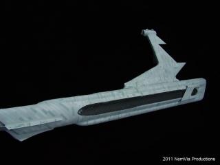

RE: DeBoers Reliant - WIP - NemVia - 08-24-2011
Today I just finished the 1st of 3 maskings for both of Reliant's Warp engines and I'm now ready to airbrush the 2nd of 4 different colors. The next color to be added will be an off white, which I used on my PL Enterprise and it came out beautiful. There are not a whole lot of reference pics for the filming miniature that show, in very clear detail, all of the engines and support pylon details. I took a look at the decals for the Ertl Reliant kit and while I'm using it for a reference, I don't think they're completly what I wanted to do. I also have some pics of the Reliant when it was at auction at Christies, but of course there aren't any clear ones of the nacells. So, I'm using some of the pattern that I have put on the Enterprise engines and am beefing up the width of some of the maskings to help suggest that this starship is a little more heavily armoured. As for the pylons, the pics I have suggest that the patterns are more verticle than horizontal. This really is a milestone for this project because there are 8 warp engines total that are being detailed so to have this part of it finally complete is very exciting. For the next masking it won't be as much work because I will be adding masking to the masking... get it? Well, By the next update you'll see what I mean. See you then!
Mark
RE: DeBoers Reliant - WIP - NemVia - 09-22-2011
Cool
For the last month or so I've been doing nothing but masking and painting the main Aztec pattern on the warp engines and the support pylons. It can be very repetative work but the end results are worth all of the trouble. I don't have any good clear pics of the actual filming minature's engines so I tried to do what I could with the fuzzy pics that I do have. Although I didn't use any pearlescent paints for this paint job, I got the effect that I wanted out of the paints that I did use! In the next update I will have the Flush vents, intakes, strobe light covers and other details added to the engines as well as their decals. Then I can move onto the roll bar and torpedo launcher area and get thoose started. Check it out and let me know what you think!
Mark

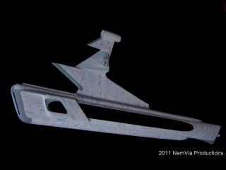

I have finished much of the detailing paintwork on the nacells and pylons, just a few more things to add to complete the engines, I've added 5 new pics to the Reliant photo album. It took a lot of masking, but it was worth the work. I've also added a few things to my site to make it easier to navigate to the pics. Let me know what you think!
Mark
Home - NemVia Productions
In this update, I've added 15 new pics to the Enterprise album. It took about 2 weeks to mask off all of the engines for the detailing work. I've added 3 new colors as you will see, plus I did touch-up work on the warp nacell grills. I think the pics turned put good. Next I'll have to paint the front nacell grills copper, the inside stripe on the pylons will have 2 more shades of gray added to finish off that detail. There is some putty work that needs to be done on the basses of the pylons then I will put a very thinned out off-white color over the Aztec pattern to tone it down just slightly. It will look sharp when it's finished. Then I can add the decals to the rear of the engines. I've made my home page so that you can access the DeBoers Enterprise project from the side bar on the left. The new pics are on page 3 pics 149-163. Let me know what you think!
Mark

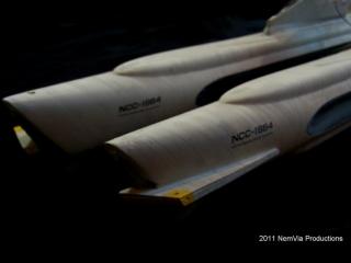

Big milestone hot this month! I have added 12 new pics to the Reliant album! A lot of energy and work have gone into these engines and I'm happy to say that other than a few pieces that will be added later on, the Engines are all basically done!
For the Reliant update, I've finally finished these engines as well! I've had to tone down the Aztec patterns by spraying them with a very light coat of off white and then add the 4 decals that go on either sides of the engines. These engines are now finished and I can start moving on to other areas of the this ship. The new pics for Reliant are in the Reliant Album on page 2 pics 63 - 74!
See you next update!!!!

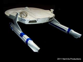

RE: DeBoers Reliant - WIP - NemVia - 05-04-2012
[attachment=11090][attachment=11091] The latest pics are now availible in the "Updates for May 2012" page.
For Reliant, I have begun working on the saucer section as well. I have cut out all of the thruster pieces and have replaced them with clear recast pieces. I have also added the bridge piece to the top hull and the lower saucer has the dome in place. These pieces are now epoxied in and ready for the painting process. The hull will have to be sanded down, then opaqued, and then I can prime everything up and begin the Aztec process on this model. I am not making the Aztec pattern the same as the Enterprise model, which I have seen a few others do. I had to take a reference pic of the filming miniature, make it into a negative picture and do some enhancing to help define the Aztec pattern a little better so I can make my own masks. There are in fact 2 different Aztec patterns on this ship. I posted a pencil sketching of what the patterns look like and then I have also begun creating some of the masks of one of the patterns of which I have posted a picture of what it looks like in this month's update. The other pattern will be started once this one is completed. Now that I've started on the Saucers of all of these ships I can see the finishing up of these models on the horizon for now. I am also looking forward to starting on the Drydock as well. I have also started some blueprints of the Drydock scaled to these models so things are progressing nicely. See you next update!
Mark.

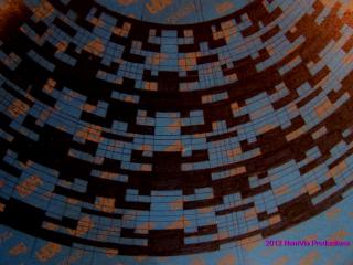

August Updates are now Posted. - NemVia - 08-01-2012
This months update is very picture heavy!

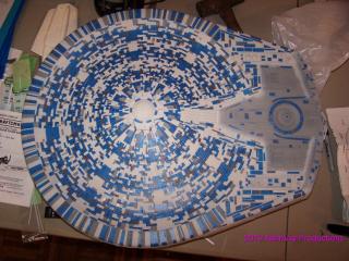

For the Reliant update I've decided to tackle this model's Aztec Pattern first because there is a difference in the pattern from the Enterprise Aztec Pattern. Not only that but there is far more detailwork that needed to be done with the upper saucer section than with the Enterprise models. In fact the detailing on Reliant is the most detail work that I've ever put into any single model EVER! I was very pleased with the way it has turned out. I was also able to put on most of the Decals in this update. The one thing I didn't realize when I recieved this kit was that other than the markings around the hatches there were no red stripe decals that came with this model, so I decided to paint them all on myself. I was able to use Insignia Red as the color of choice and it turned out to be a good choice. There is very little difference between the Decal Red and the Painted on stripes as you will see in the pics. For the shoulder part or rear of the upper saucer there is a grid pattern that can be seen on the filming miniature, so I had to put this on the model first. It can be seen as very thin blue lines of masking tape. Then I was able to add all of the different shapes of pre-cut masking tape to the insides of each of these grid boxes. The results came out excellent when the tape was removed. I've also painted up the top and underneath aft section which at first threw me as to the color. A picture of the original Reliant revealed that some of these sections appeared to be a light blue or gray color. But when I reviewed ST:TWOK a saw that all of these details were dark. So, before I messed this part up I began to decide what this color was. It was very difficult to determine on the screen. I happened to have an AMT/ertl Reliant kit and was just curious to see if the instructions had any hints of wjat colors to use. In this case it suggested Intermediate Blue, which I had never heard of, but I looked it up on-line and found that Model Master Paints did in fact have this color, so I tried it out and then compared it to the pictures I have of the original filming miniature and sure enough, it was a very spot on match which was a complete relief to me. I also realized at this point this is a common color used on smaller parts of the ship such as the torpedo launchers and some of the Interior parts for the hatches that I am putting into the Enterprise builds. So with a big sigh of relief I can move onto to other parts of this model. I put a color comparison picture of both my build and the Filming miniature in the update so you can decide for yourselves wether or not the build looks as close as possible to the filming miniature. Let me know what you think.
See you next update! Enjoy! And as always comments and New members are always welcome!
Mark

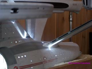

RE: DeBoers Reliant - WIP - NemVia - 11-01-2012
Hey Everyone!
This month was not a good month for productivity, I ran into a very nasty problem with the Hanger Decks... All three of them actually. While they were in storage the very ends of the flight decks started to warp (no pun intended) upwards. I finally realized there was no chance of getting these pieces to fit into the model properly, so I was going to have to re-do all 3 flight deck pieces. Apparently the resin I used, which was supposed to be a very hard and durable resin, was not as hard and durable as was promised, So I had to cut off all of the flight deck pieces and use what I originally wanted to use in the first place but was afraid that the paint would not adhere to it very well, and that is pieces of window quality plexi-glass. I first had to trace the old piece shapes onto the plexi then cut them and reshape them until they fit perfect inside the models. Then I wanted to add some more detailing to the flight deck namely, more and clearer landing and take off lines along with parking position lines for the work bees. The best way to do this was to first mask off the areas where the chase lighting effects would go, then spray the entire top of the deck piece flat black to make sure no stray lighting would come through the deck. Then I sprayed the same entire pieces yellow so I could mask off the lines I wanted on the deck. I didn't want to do this the other way around because I was afraid the masks might peal off some of the deck paint. Anyway it was easier to cut small strips of masking tape and get all of the yellow lines nice and straight. Then I sprayed the flight deck Intermediate Blue. Then removed all of the masks and finally sprayed the entire deck pieces with gloss cote. This gives the deck a nice sheen to it. Check out the pics in the November update page and you'll see what I mean.

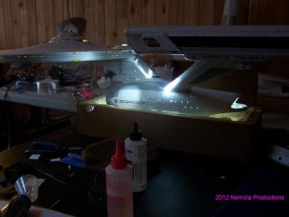

After this huge delay I started adding the porthole glass which for the most part is .005" clear styrene #9005 and then the exterior lighting and wiring for the secondary hull. This proved to be quite a challenge because the Engineering hull comes pre-assembled and if you have large hands, it can be quite cumbersome getting all of these LEDs in there. Plus there is the matter of getting all of the spot lights aimed properly, then carefully putting the hanger deck piece inside without bumping anything. I have several Lighting TEST pics in this update and from what I'm seeing it looks pretty good so far and I can move onto the Deflector Dish lighting and start on some of the saucer lighting.
Also in this update I've been able to add one of the botany decks inside the engineering hull. This deck will be lit with some EL lighting. I really like the effect this stuff does on a piece like this. It lights the deck up very evenly rather than the sharp light points that an LED gives off. It was also a challenge to get this deck into the hull. It can not be done assembled. I had to first put the lower half in first, then the top piece. They are both very tricky to get in there. The corners of the pieces had to be fed up into the dorsal (Thank goodned it was hallow otherwise I would've really been stuck) then slowly turned so that the pieces were parallel to each other then one more 90 deg turn to make them fit into thier final postion.
Just one more note: Because of the redoing of the flight deck pieces, I was only able to accomplish all of these updates on only one of the models, so I will need to repeat these on two more of the kits and portions of this on the Reliant model. I apologize for this mess up, but sometimes these things happen, but actually I'm kinda glad it did because I like how the flight decks look much better than I did before. Well that's it for this update. Please feel free to make comments! See you in 1 month!
Mark

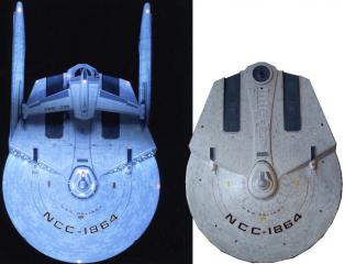

January Updates are now Posted. - NemVia - 01-13-2013
Hi Everyone! Sorry this update took so long to get uploaded. December was a very rough month for my secular work so very little was done on Reliant. I have 22 new pics in the Updates for January page
For RELAINT:
In this update I was able to add the LED spot lights on both the upper and lower parts of the saucer. All of the LEDs are now in place, I'm just waiting for some parts to come on for the flashing and strobe light effects. I've also been able to add the interior lighting to the saucer and main body of the hull. There are (8) 4" tubes and (4) 8" tubes being used to light the ship up. This does not include the (2) 4" and (2) 8" tubes that are in the nacells. They all run off of ballasts, 1 ballast for every 2 lamps. I have a nice lighting test shot of Reliant with these lamps on. I also focused in on the landing bay lighting which came out very nicely. I still need to add the flashing and strobe circuits to this model for the lighting effects, but I'm waiting on a few parts before I can add those in. In the meantime I will be working on the Impulse engine lighting effects as well as some additional lighting that is needed around the aft end of the ship including around the landing bay doors.
That's all for this months update. We'll see you next month.
